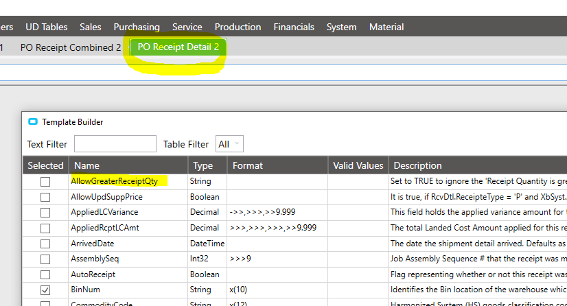

DMT for PO Receipt Combined shows bogus error for AllowGreaterReceiptQty
I’m trying to make a DMT for a PO receipt. I’ve encountered 2 problems:
The first one is that if the receipt is more than the PO amount (this is common in our industry) then the DMT throws the error “Receipt quantity is greater than the Purchased Quantity” - fair enough, but it then goes on to say "Add a column AllowGreaterReceiptQty and set it to TRUE and retry.
Well, that is hokum. If you look at the Template builder there is no such column. If you add the column, it says that the column is invalid.
The second issue is that I have the PO Receipt Combined, but the Inventory controller does not, even though he can do PO receipts? No idea why that happens here…
It does exist in PO Receipt Detail. Submit a support ticket and request that it is included in the PO Receipt Combined Import
