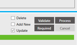

edit : I also set the checkboxes to update and removed the add new. Maybe it makes a difference?

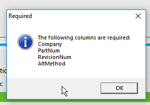

That is very odd. What fields are you using? I’m only using the required ones:Company, PartNum, RevisionNum, Approved, ApprovedDate, AltMethod, RevShortDesc.

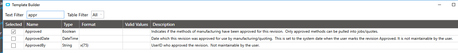

Approved date isn’t required, and actually says isn’t maintainable by the user. Try moving the AltMethod to the end.

It worked when the Add New checkbox was unchecked. Strange. Thanks for the help.:grin:
