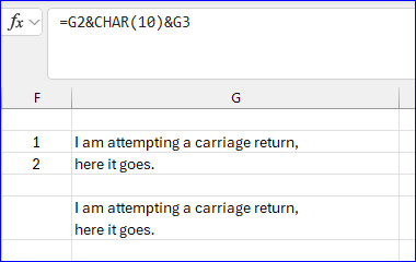

When I was exporting data out of our legacy system, I used char(10) in excel formulas to produce the Line Feed. char(13) for Carriage Return didn’t seem to do anything.
Don’t forget to turn on “wrap text” in excel to see the effect.
