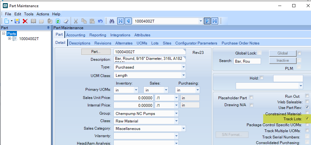

Almost all of our current PartBin records are of Parts with TrackLots=TRUE, including the few records I already processed without supplying LotNum. Would it have errored out if there were multiple lots when I made those adjustments?

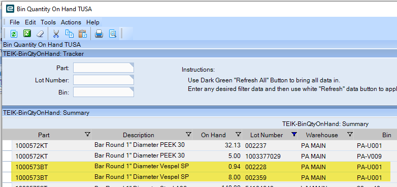

You may have multiple lots for a part number. I don’t see why you would get an error for uploading multiple lots… Here’s an example where we have multiple lots of a part stored in the same bin in Epicor.
When you do quantity adjustment, if the part has lot tracking turned on, it will be required to enter it anytime you do a transaction.

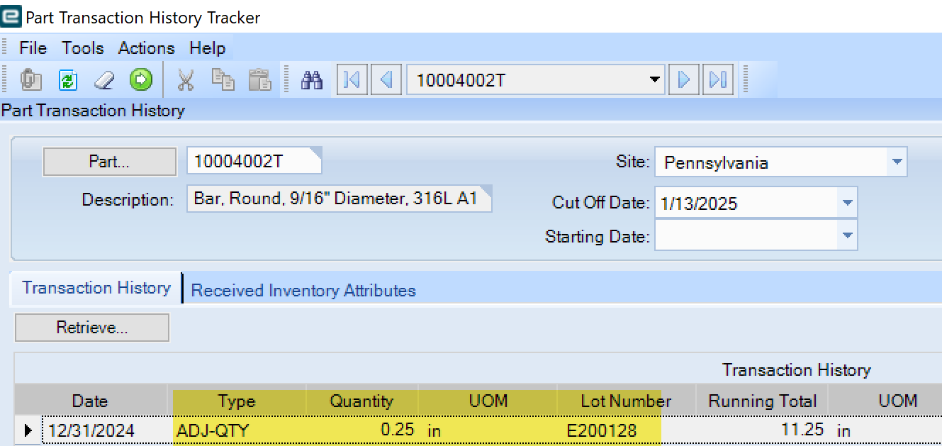

So in Part transaction history tracker for your ADJ-QTY you have no lot number and the part is checked as track lots? We always need to provide a lot for the lot tracked quantity adjustments done via dmt.
The LotNum IS showing in PTHT. I did NOT supply it in the source file. Evidently it defaulted to the only lot that existed.
