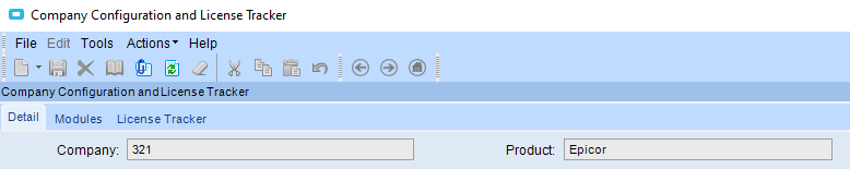

I think in 10.2.500 and up, DMT uses the same license key as the other products and doesn’t require the .lic file. Check to make sure DMT is enabled in the Company Configuration and License Tracker:
Thanks Mark. DMT was enabled. it worked from the client folder, it just had a bug and the previous version was the only version without the bug, but when i had downloaded it from epic web and copied it to he client folder it still wasnt working. Support sent me the previous version without a bug and the only difference between the files from epic web and support was that config file.
