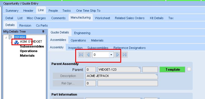

The first thing I’d try is to only use the required fields. The only required fields are: Company, QuoteNum, QuoteLine, AssemblySeq, OprSeq, and OpCode.
And while the “Quote Operation” DMT allows for adding records, some other records must already exist. Double check that the QuoteNum, QuoteLine and AssemblySeq already exist.
