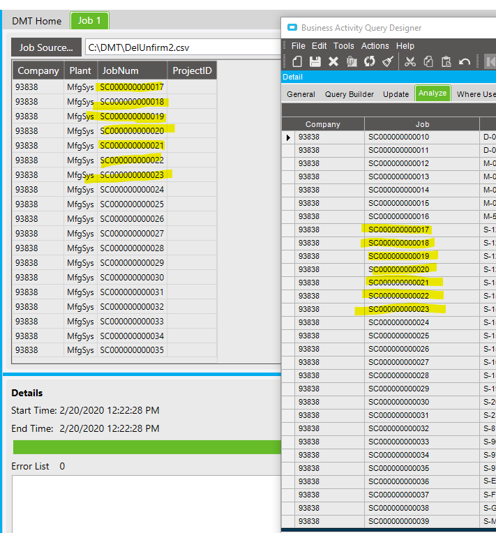

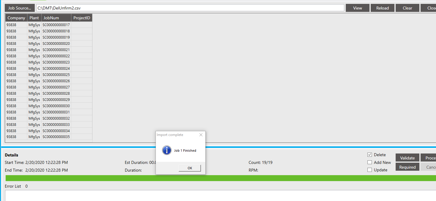

I am running a DMT that will delete some records. DMT says complete with no errors, but when I run a BAQ the record is still there. Whats the deal? Thanks!

I was trying to upload to “Job” i needed to update to “Job Header”. Switch to “Job header” and it worked.
