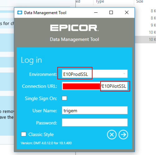

## Post #1 by @josecgomez
Running DMT for 10.1.400.18
And no matter which config I pick in the "Top" dropdown, the URL below doesn't change to match it
Then if I try to log in I get an error that says "Username not provided",... only work around is to remove all the configs except the one I want to use, then ti works... then switch them in and out as needed.
Any ideas what could be causing this @Edge? I tried deleting all the DMT related files, and re-downloading it. I also cleared the cache and removed the user.config form LocalData
I also tried running as admin , and not running as admin, removing the Read Only flag in the Folder etc...

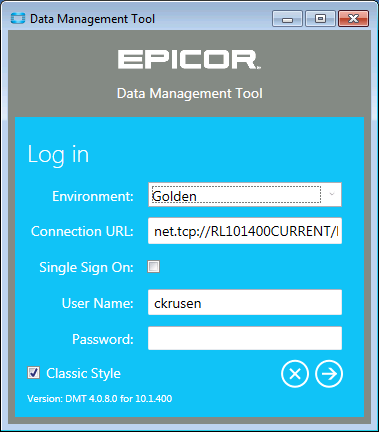

## Post #3 by @ckrusen
I had a some what similar problem before.
My issue was the SSO was enabled, so the window above would appear, but the environment "GOLDEN" (a default built into DMT??) would be selected. Because SSO was enabled it would automatically try to connect, and would fail.
I searched high and low for where this data might be stored (in a file, in the registry, etc ...), but no luck.
I had to open the Demo DB, and adjust the preferences.
**BTW - I can type anything into the password box and it connects just fine. Go figure ...**

## Post #9 by @ckrusen
I made a copy of the shortcut that launches DMT and changed the target and Start-in paramters to another valid App Environment. On initial launch of this shortcut I get the "GOLDEN" environment as the default.
I can select a different environment (the one the shortcut actually points to) and it logins okay.
After that initial login, I exit DMT. Subsequent logins start with the dialog box having the correct Environment and connection URL
**YES this is still with version 4.0.8.0**
But I'm guessing whatever caused this for me, migh carry on to ver 4.0.12.0 too
## Post #10 by @nhutchins
FWIW, I was at 4.0.10.0, and it was working correctly where the connection
URL updated with the Environment selection. Then I upgraded to 4.0.12.0,
because it prompted me too, and now it does not work.
