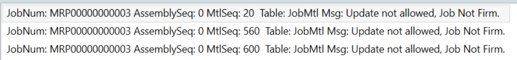

I’m testing this process with a DMT - but I’m getting an error:

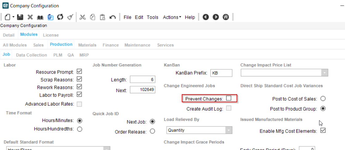

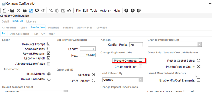

Firming these jobs just to modify dates really isn’t an option. I’ve went into Company Configuration > Modules > Production > Change Engineered Jobs > Prevent Changes and cleared this setting, but I still can’t modify the field.

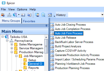

There is a process that you might want to look at to use to autofirm. However, you noted you wanted to do the date change to “push material dates earlier”. Have you considered using Kit time or something like that to automatically have Epicor require the parts in advance of job start date?

You can’t update unfirm jobs, as Nancy alluded to. If you agree this is a frustrating and needless limitation, please VOTE to fix it. Epicor Kinetic Ideas
