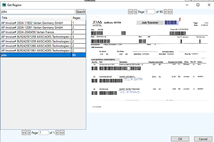

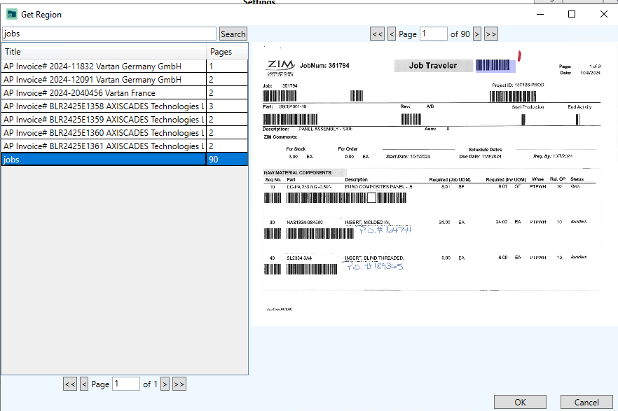

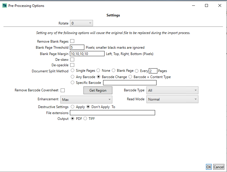

We have an Email set up to process documents that come into a folder and then it is processed through ECM. The import works as it takes the attachment and starts the process in ECM, but it will not split the document based on the settings I have set up. I have it set up to split on a barcode located in the region i selected in the bottom picture. There is suppose to be 10 separate job travelers, but imports into ECM as 1 PDF.
What does that bar code represent? Based on its location, I would imagine it represents “Job Traveler” which isn’t changing from document to document…
That is the Job num. It is a new barcode we placed there. It is suppose to split on that barcode changing.
Hmm… Try changing the Barcode Type to the format you used to create them. I’m assuming they’re in Code 39 format, which is definitely an option. I would also review the job import tab in the ECM Client and send the results to the log for further review. Could reveal the issue.

We’ve been doing testing for them in every way concievable. We scan Job Traveler packets that contain from 1 to 20 job travelers and sometimes it works just fine, others it does not. We do it through a MFC device/copier, so it can come quickly, and it looks like two or three batches get consumed at the same ECM client interval - so we were thinking some sort of overload, but those same files fail when they are processing by themselves and then work on the next interval.

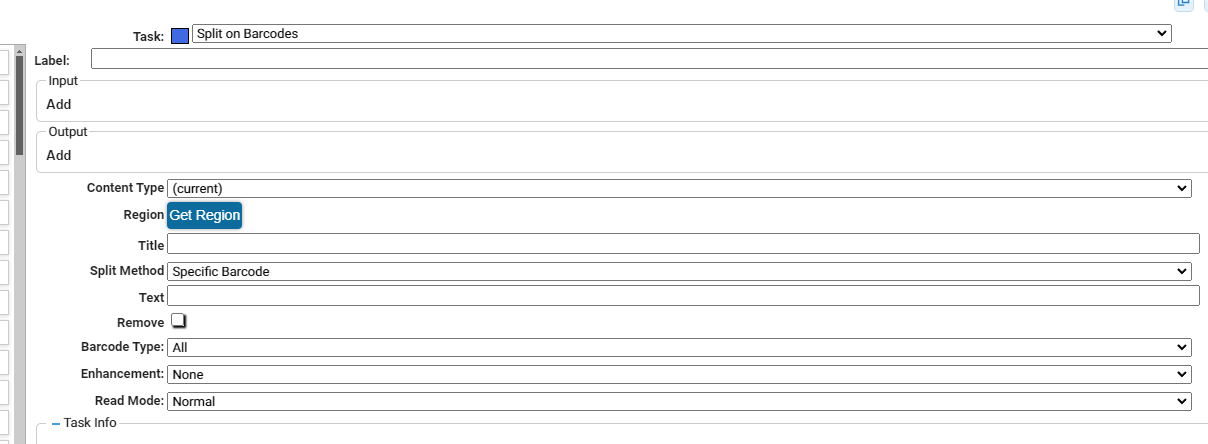

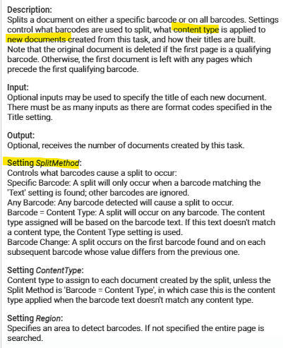

I have seen the batch import not function correctly to split barcodes, instead in workflow I have used the Split on Barcodes task to separate documents.
Do you not use the batch import to split at all when you do it with the workflow?
I have found the workflow allows for split task to split documents and I avoided the issues with the batch import Document Split Method. Since the workflow has the same task, and allows for the workflow to send to a new content type.
You may have a Batch import Content type linked to a Split workflow.
Then use the workflow to send to another workflow with a different Content type. The structure of these workflows and content types does depend on the documents and the barcodes in use.
