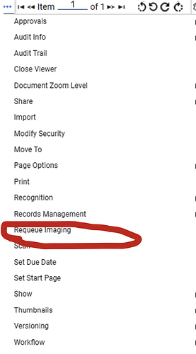

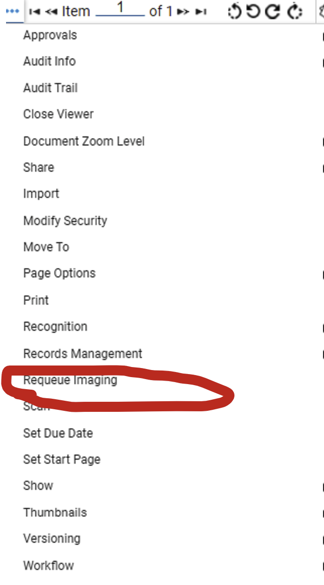

  3. Once you have restarted, verify that a processor is now listed under Admin → Distributed Queue Management → Queue Processors.
Under actions, click on Requeue Imaging.

Sometimes your client throws errors or gets hung up. When that happens, it leaves the documents in that processing status. This corrects that issue.
