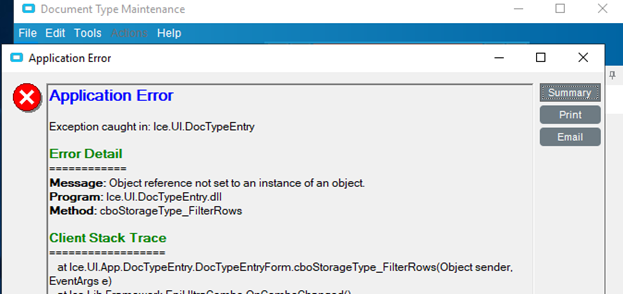

Getting this error when trying to create a new document type on a cloud version of 10.2.600.9 in Document Type Maintenance. Anyone else getting this? Are there special permissions on the cloud that are required? I noticed in Company maintenance the attachment tag is missing

Epicor migrated File System for us but it did not migrate Attachment Link for us. Any existing DocType’s will still show Attachment Link but if you try to create a new one the option will be missing.
You must go to Attachment Type Maintenance and create a new entry for Link (its also called Link now). Then you can go to Document Type Maintenance and select the Attachment Link option again.

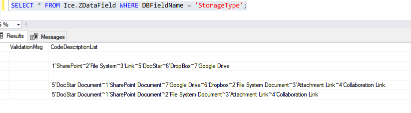

It looks like existing records are still working, despite Link missing and not being enabled. That is because the drop-down values are hardcoded in ZDataField
To be safe, make sure you add all the types you are using and enable them, or one day they will just stop working if Epicor adds WHERE Enabled = 1 clause.
