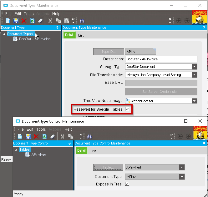

Hi, we have just begun the implementation of AP Automation using ECM and I have an issue with the Document Type. We have a Document type called APInv and I was wanting to check off the “Reserved for Specific Tables” check box so this type only shows in AP invoice Entry and Tracker. For some reason when this is true we get an error in ECM saying the doctype is not found but as soon as we uncheck it things work fine. Has anyone experienced this before and how did you deal with it?

Hi Greg, yes the error is in the workflow and it says “DocType APInv not found” If you could do a quick test this weekend that would be greatly appreciated. It rooks like maybe it’s something in the REST call.

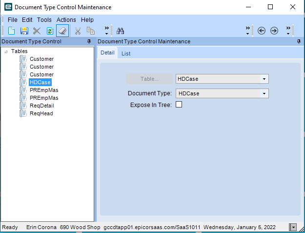

After you checked off the Reserved checkbox, did you then select the tables the reserved document type uses within Document Type Control Maintenance?
