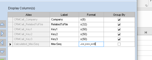

Make a test query with just the CRMCall table, with the following displayed columns:
Here’s the details of the Calc field
And run it
You might want to add some table criteria to limit it to the calls you want.
I think you’d see
Company RelatedToFile Key1  Key2 Key3  MaxSeq
MC      QuoteHed      12345                    3
MC      QuoteHed      12367                    1
MC      QuoteDtl      12399    5               4
If:
  1. Quote 12345 had 3 calls entered (against the quote head)
  2. Quote 12367 had 1 call entered (against the quote head)
  3. Quote 12388 had 4 calls entered (against quote line 5)

We group by CallQuoteNum (or with criteria RelatedToFile=‘QuoteHed’ and then group by Key1 only) and then get MAX(CallSeqNum). You do have to use only those columns, though, and then join back to the full table to get the rest of the data you want.
If you include and group by all the keys then it won’t work.
