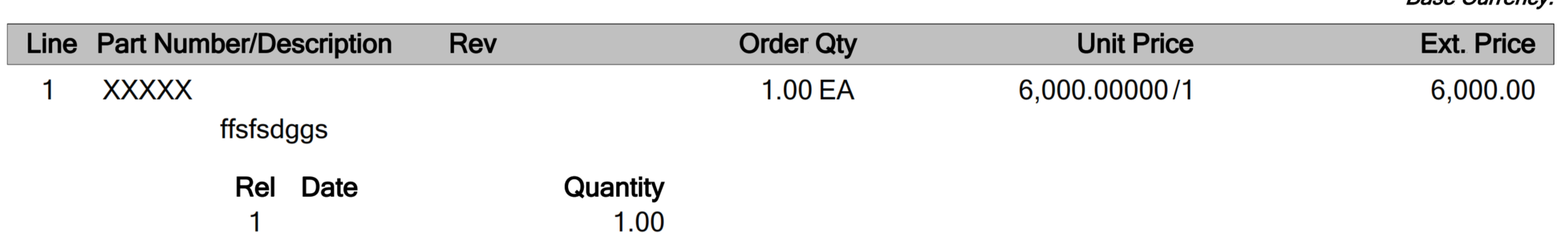

I have a sales order that prints ‘ffsfsdggs’ for the Calc_LineDesc as seen in the below image. I am sure that the field name is Calc_LineDesc. I changed the report field from a long complicated multiple if’s to ‘=Fields!Calc_LineDesc.Value’.

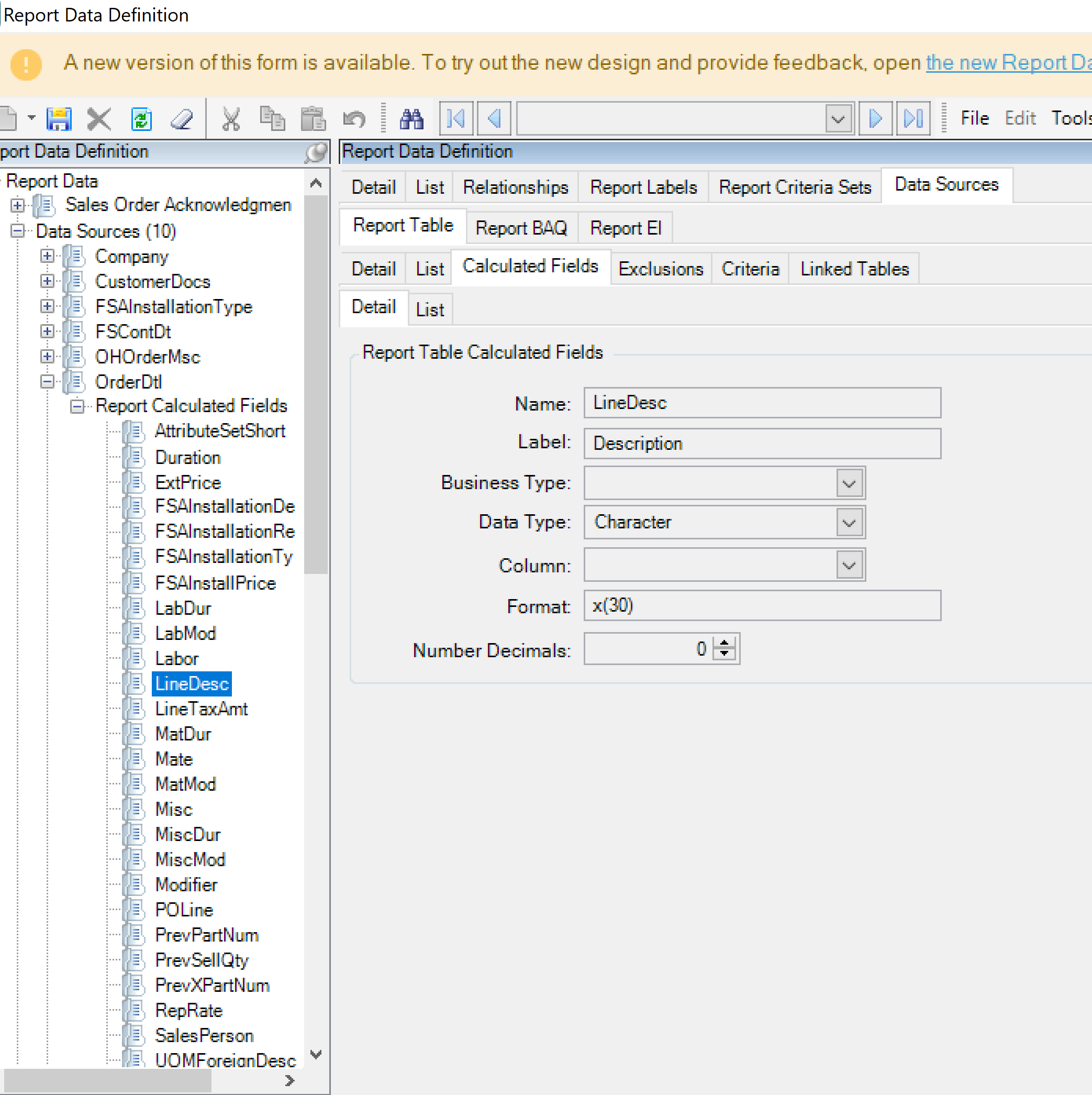

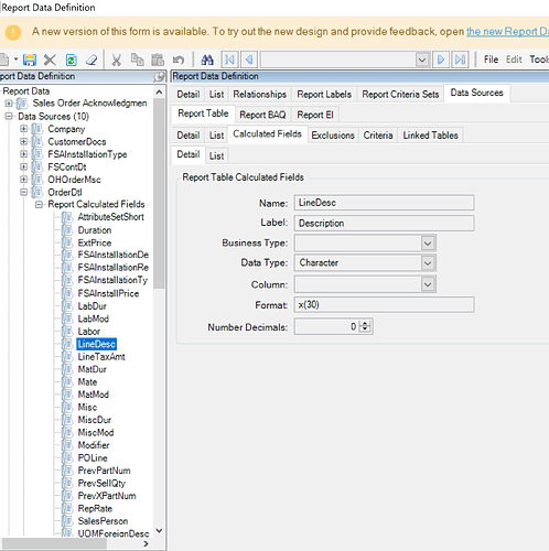

I have also included the Report Data Definition below.

It looks like the calculation is in Erp.Internal.OM.SalesOrderAck.dll, in the SalesOrderAck.DoDetailCalculations() method.
LineDesc starts out assigned to the corresponding PartLangDesc.Description if there is a PartLangDesc entry for this part number and the language selected for the report, otherwise it starts assigned to the part description from the OrderDtl line.
The next time LineDesc is assigned… if this OrderDtl line has something in the XPartNum field, and there’s a corresponding CustXPrt entry, which has its own PartDescription, and if the customer’s Customer.CustPartOpts field is either ‘M’ or ‘O’, then LineDesc is assigned to that CustXPrt.PartDescription.

Chris, you are amazing. I found it in the erp.partlangdesc table. I did not even know this table existed.
