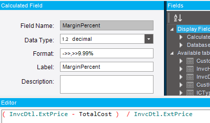

I was creating a new dashboard in application studio and noticed that a calculated field I use to get percentage is not showing as percent.
The calculation gives it as 0.39 and the format field is set to ->>,>>9.99%
This works fine in classic view but not Kinetic.

The relevant data view shows the format field as the same:
Any ideas on why?
Is there an easy fix?
Do I just need to convert it in the calculation?
Any help is appreciated!

I’ve never gotten the “%” to show in a kinetic grid… period.
I generally multiply by 100 in the BAQ to get the display value I want and then label the column as “Margin %”
I’ve seen other posts on here about percent formatting in kinetic grids and I don’t think I’ve ever come across a working example.

Well that just sucks…
I guess I need to convert that field into a nvarchar and add the percent symbol to it after calculations…
I assume that they will not fix any time soon.
I figured it would be something like this.
Thank you for the quick reply, I really appreciate it!

I was trying to think of any standard Kinetic screen that has a percentage value, and the only one I could think of was conversion work bench. They don’t have a percent sign displayed for that either, so most likely you are right and there is no supported way.

That’s what we’ve done
