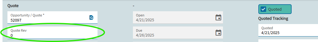

Thanks guys, I too see it as a plus. Like OK the customer has seen the quote in the current state. If they need to uncheck in order to adjust the Quote and make changes it acts as that lock to let everyone know it is in front of the customer.
Our problem is that in my infinite wisdom I added some check off UD columns where teams in the process review the quote for completeness before it is converted to an Order. This means for that team to sign off on the UD column they need to also uncheck that checkbox.

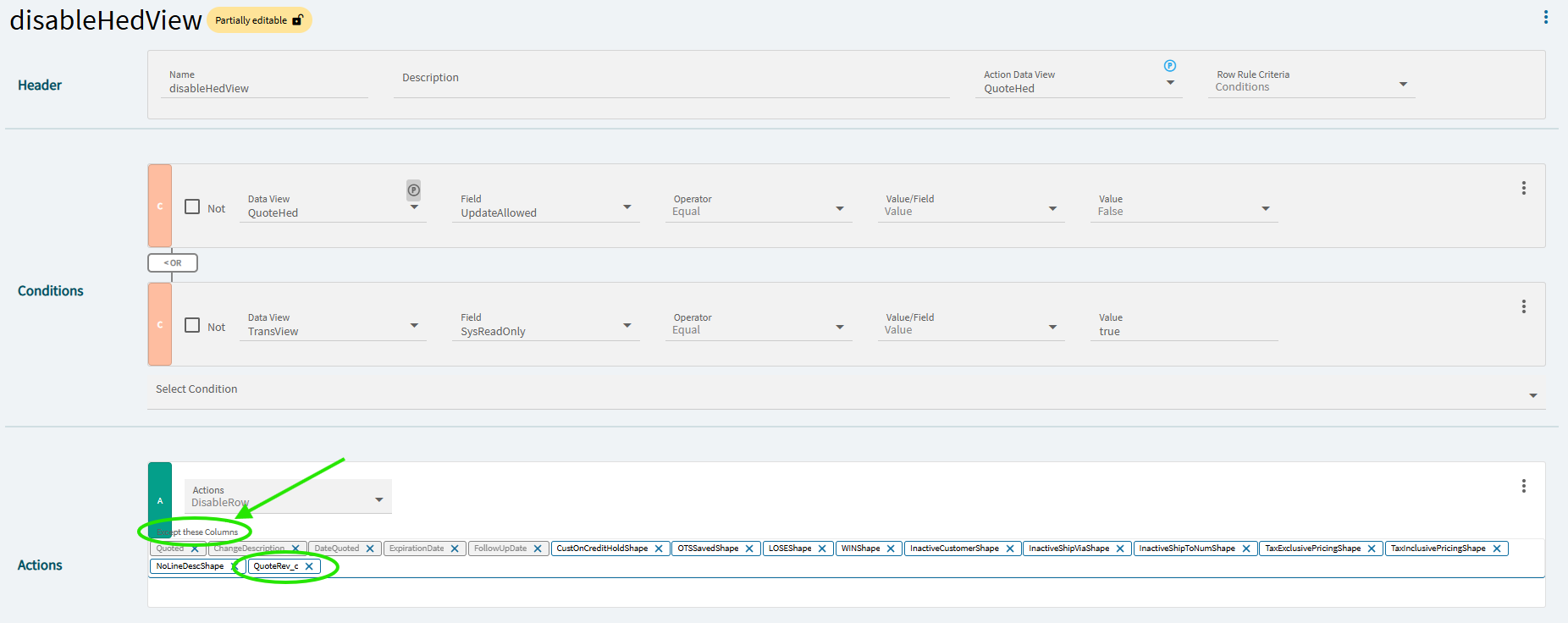

Hey Tory, for your specific case, you may want to give this a look…

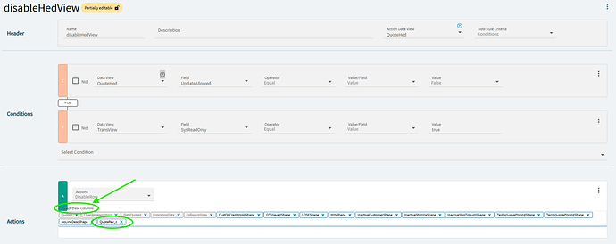

When you click the “Quoted” checkbox, the majority of the header columns get disabled. This is controlled by a Data Rule which (luckily) is “Partially Editable” in App Studio.
Data Rule Action: All QuoteHed fields get disabled “Except these Columns”
You can add your UD Columns to the exceptions list. This might get your “approvers” access to update those UD Columns without having to un-quote the quote.
The only drawback I see thus far (quick testing as I also have UD Columns set up on QuoteHed) is that by adding columns to that exceptions list, even when the quote is “Won”, those fields stay active. So… just keep that in mind.
