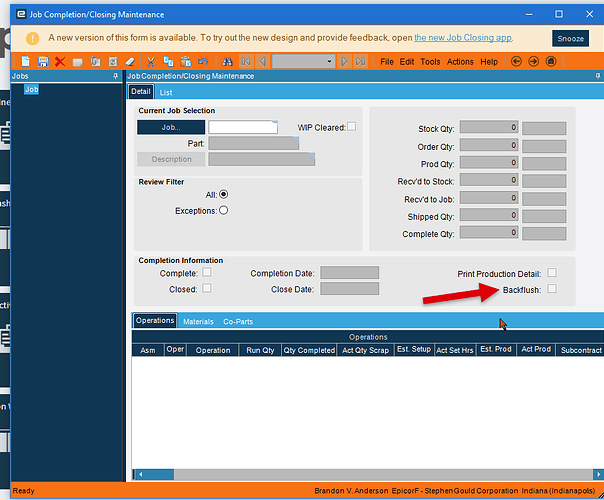

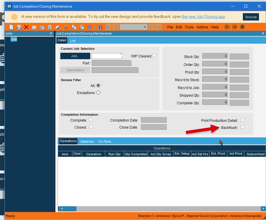

Backflushing materials is on the material side and can be attached to any operation (other than subcontract) and will issue the material to a job when the operation is completed. The reporting type of the operation is irrelevant to this process. If the materials are set to backflush, and the related operation is reported, they will be backflushed. It will backflush the required amount for whatever quantity is completed on the related operation. So if you say you reported 20 of the operation, 20 units worth will be issued. Backflushing will over issue if you over report operations.
Now that we have the basics out of the way, you are right, it shouldn’t double. I have see it where the materials are set to backflush, and related to an operation, and then someone uses the backflush option in job closing. I do not know if this respects the backflush flags or checks against any already issued material, and we basically just decided to never use that after some issues, and instead issuing any missing materials manually. I haven’t looked at this in years though, so it might be changed/fixed. I’m vaguely remember putting in a ticket and got the dreaded “working as designed” answer.
