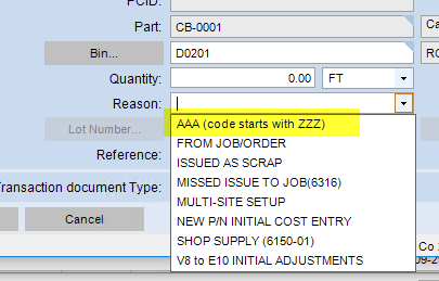

We have added some new Reason Codes to DMR. When I look at them in Reason Code Entry it automatically orders them properly. When I go to DMR processing the new ones are at the bottom of the list. I tried to refresh list and it still at bottom.
Has anyone see issues with the Drop down lists not listing in the correct order.
If it is an EpiCombo, a customization can set the EpiSort property.
yeah, i figured that could be done but hate doing that when (in my opinion) Epicor should be automatically sorting it correctly.
I added code "ZZZ" with Description "AAA (code starts with ZZZ)", and it shows at the top of the list in Qty Adjustments
maybe just an issue on that DMR form
mine went to bottom…I didn’t pay attention to the description. I will have to check that.
