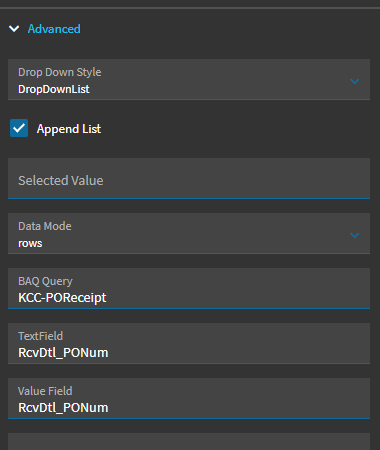

I have a dropdown list that populates po’s correctly. But I also want to show the line and release for that PO. I’m guessing it needs to go in the Text field. I am getting the line and release for the PO in the BAQ.
What is the correct syntax to do that?
Would it be something like: ${RcvDtl.PONum}-${RcvDtl.POLine}-${RcvDtl.PORelNum}

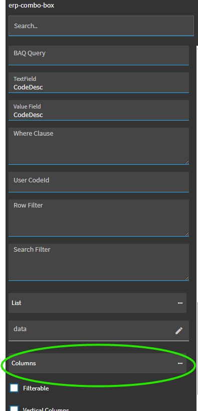

I haven’t done this with a BAQ combo, but I did it with a UserCode combo:
I “retrieve” both columns I want…

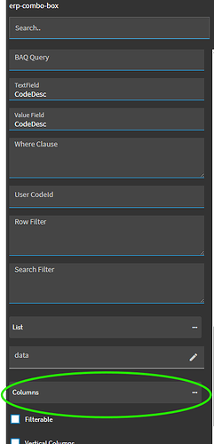

At the bottom of the Advanced Properties, there is a a Columns area

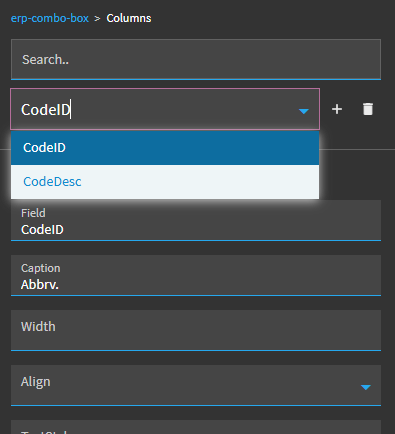

You can set up multiple columns in there:
and get multiple columns to display:

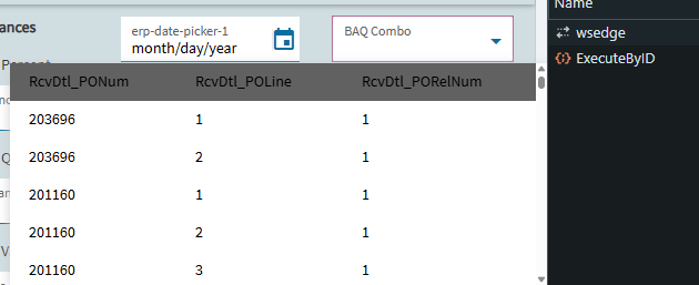

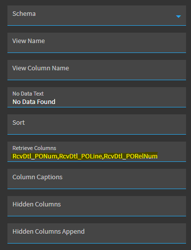

The fields still need to be listed in the Retrieve Column setting:
Result:
