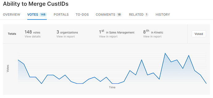

Please note that we already have an “Epicor Idea” around the concept of merging Customer IDs within the system. This idea has lots of comments and suggestions and Votes (148 votes), making it the 8th most popular idea in Kinetic, and the TOP idea in Sales Management. We do take this seriously, but it is also a fairly large idea to implement. the soonest that it could be implemented (:safe_harbor:) would be 2024.2 2025.1 (EDIT: Note that after further review, this change is a very huge change, and we are still trying to figure out some of the challenges), Your Votes Count!
https://epicor-manufacturing.ideas.aha.io/ideas/ERP-I-740
