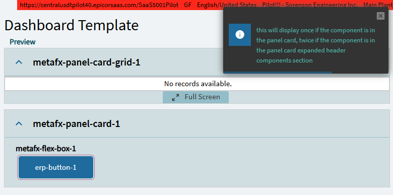

Dragging the component into the main panel card area creates only one instance of the component.

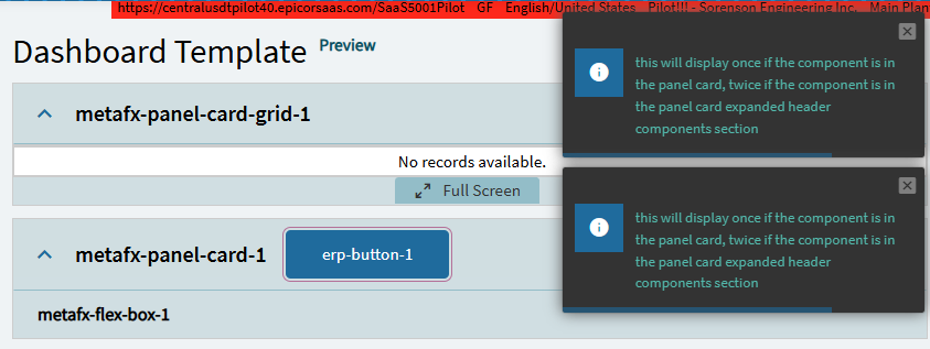

Testing shows that both are rendered and active, if i use control-alt-L to change hidden to true on one of them, it will still remain visible. I have to change hidden to true on both of them for it to hide. onCreate events will fire once when the component is contained within the Panel Card, and twice when the component is contained with the Panel Card’s Expanded Header Component area.

  • Click the “Play” button in the upper right corner of app studio to preview the app.
  • You should see a single toast popup.

  • Drag the Button component into the “Expanded Header Components” area on top of the Panel Card.
  • You should see two toast popups, as the component has been generated twice by App Studio.
  • This can be verified by pressing control-alt-8 to switch into debug mode, and control-alt-L to display components in the debug mode console, then pressing F12 to open dev tools, and navigating to the “Console” tab.
  • You will see duplicate instances of the button, in the properties for each instance, you will see componentInstance._autoIdNum and componentInstance.ngContext differ for each instance of the component.
