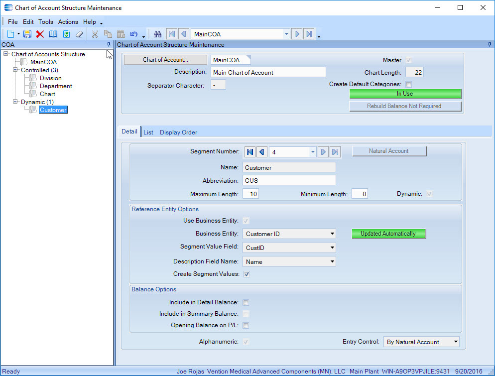

We are testing out dynamic account segments in Epicor. For example, we would like to have our revenue accounts include the customer ID so that we can see revenue as a whole and be able to break it out by the customer.

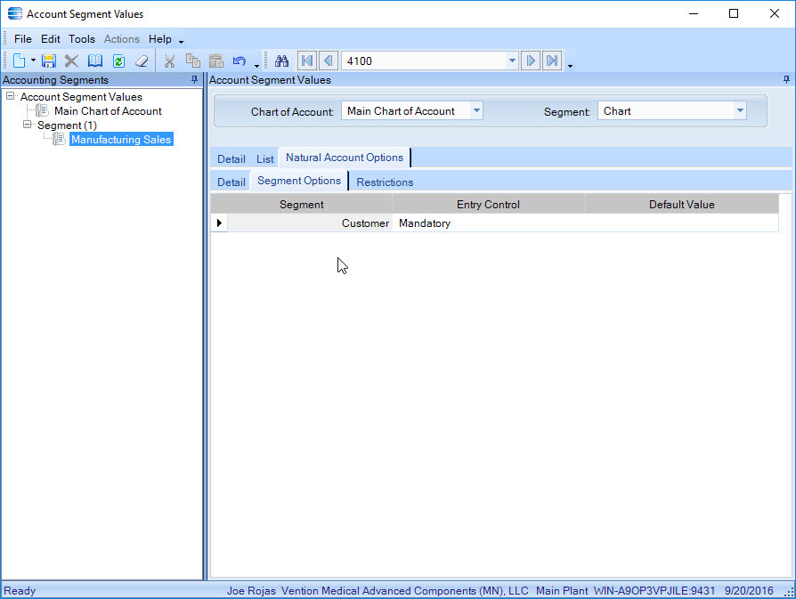

We created a new segment in COA Maintenance. Ran the "Update Business Entity Segment Values" process. Defined the Segment Option for one of our revenue accounts in Account Segment Values so that the Customer Segment is mandatory. (See attached screenshots)
We did a journal entry and it worked as expected.
Then we did a test with an AR Invoice. The hope was that when we post the AR invoice, the posting engine would automatically extract the customer ID and add it to the general ledger account. What happen was that the invoice went to the Review Journal with an error "Required dynamic segment is not specified".
Am I missing a step or is what I'd like to happen when posting an AR Invoice not possible?

I believe you did it correctly Joe but all this does is automatically create the “valid” segment when a new account is made. If you want to auto-populate on posting you have to modify the posting rules. I am poking around to see if I have a doc somewhere for this
-Jose
