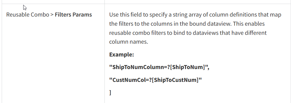

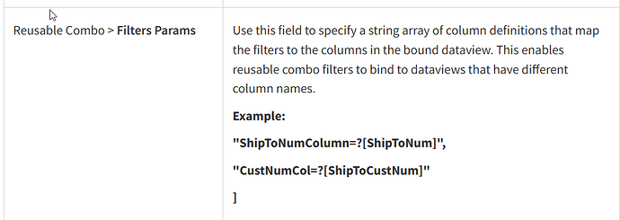

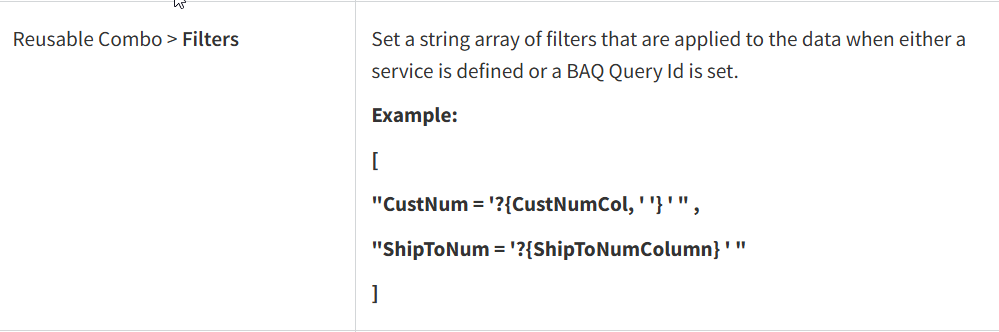

This is the syntax in the help file, did you already try this?
If you scroll further down that article there is an example that seems pretty similar to what you are trying to do? It’s under Combo box > Setting up a Reusable Combo in this article:

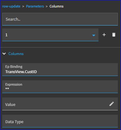

You can initialize TransView in an event when your form first loads, if that’s more convenient, and an empty row-update is all you need.
Use a trigger like: after form_onLoad (or after window… whatever you can find) which runs when you first load the dashboard.
And all you need is a row update of any TransView column… and just set it to blank “”.
Below is an example.
