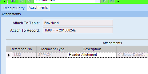

Attachments for Receipts can be attached to the header itself:

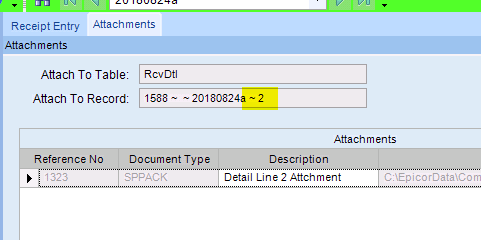

Or to specific lines:
The Attach record is the VendorNum ~ ?? ~ PackSlip ~ receipt line
