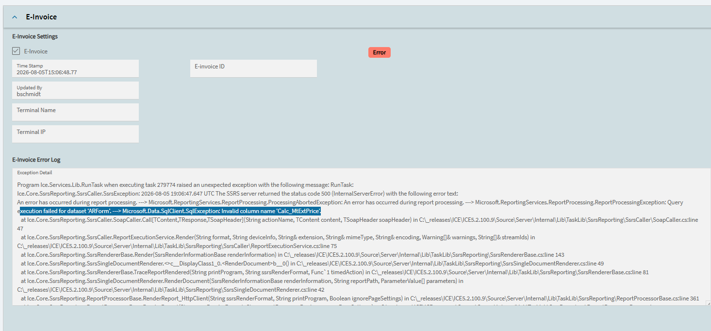

Epi Newbie here, first time poster so be gentle! I have been trying to implement E-Invoicing in my pilot environment and everything seems to be set up correctly but when I get an error when I process the E-Invoicing. Below is the error message, I highlighted what I below to be the core of the error.
I will attach a snippet from System Monitor to this post once I figure out how. Currently I can only load one attachment to a post since I’m a newb.

That’s an error from SSRS, you’ll need to remove that Calc_MtExtPrice field from the report’s dataset. There’s a bunch of threads here that explain how to go about fixing it, this usually happens during upgrades when Epicor makes a bunch of field changes.
I’m not entirely sure how to modify the reports when on cloud, I think the Report Style screen has a download / upload button that gives you an RDL file you then open and edit in Report Builder.
I appreciate the info! I am using the standard SSRS invoice report, not a custom report. So I have to modify the standard report then import it?
