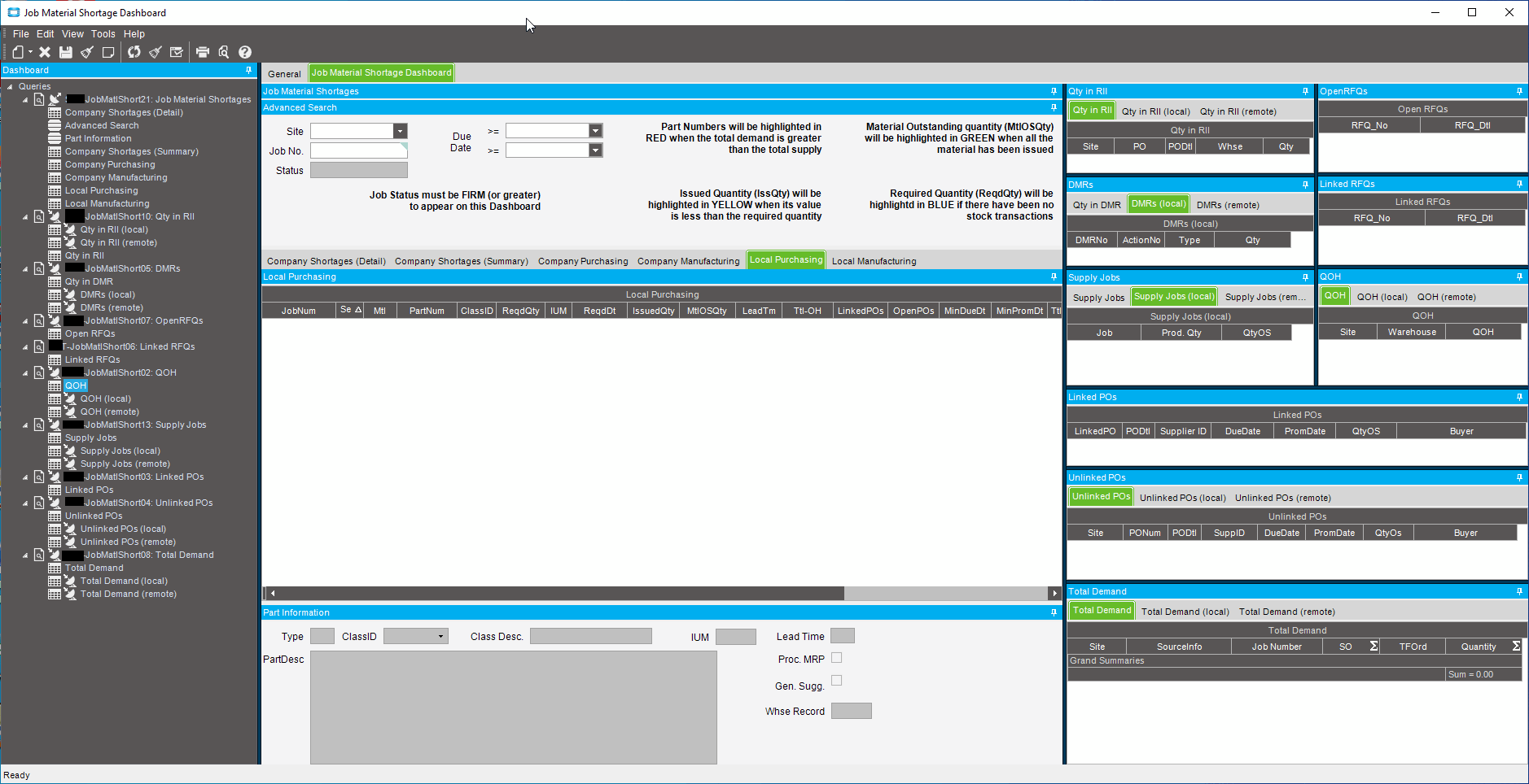

I have created a dashboard with linked (filtered) sub-queries each displaying in their own “window”
My question is: Why does one have an extra “Title bar” and the other not ~ ideally I would like to be able to turn off the extra title bar to reclaim some space.
I have compared the properties of the two “windows” and cannot see any obvious differences.
A screenshot is attached.
clipboard-01

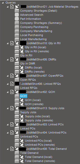

Can you share a screenshot of the tree view in the dashboard designer?
Matthew,
A screenshot of the Tree View:
However, I think I have found an answer by trial and error:
When dragging the “windows” into the desired location the position and the shape of the “finished window” are very important. The mouse pointer must be as far towards the top and left of the desired location and it is necessary to drag the “tabs” to their final position within each window once the general layout has been achieved.
An overall screenshot for info:
Looks like you got it set up correctly. And I agree, it is important where you click and drag where that’s concerned.
This quirk just happened to me in v2022.2.
Double clicking the extra title bar to pop it out and then double clicking to pop it back in fixed the issue for me.
