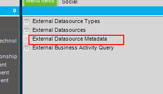

# E10 - External Query **Category:** [Epicor ERP 10](https://www.epiusers.help/c/e10/5) **Created:** 2017-01-27 18:55 UTC **Views:** 1031 **Replies:** 2 **URL:** https://www.epiusers.help/t/e10-external-query/37059 --- ## Post #1 by @bmm I created a sql view that I reference from an external baq in Epicor and everything was showing up in Epicor as expected. I then added a column to the sql view but can't get the column to show up in the external baq. All of the initial columns show up fine. I even deleted the view from by baq and added it again with no luck. I'm guessing there is something simple I'm missing. Any ideas? --- ## Post #2 by @josecgomez There is an External Data Meta Data Entry you can go to and refresh it --- ## Post #3 by @bmm That worked Jose. Thank you! --- **Canonical:** https://www.epiusers.help/t/e10-external-query/37059 **Original content:** https://www.epiusers.help/t/e10-external-query/37059
