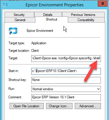

Hi Geoff,
If you look at the shortcuts target, you might find a /shell parameter
2019-11-14_08-56-43
/Active will use the Active Homepage and /Classic will load the classic style I beleive.
No the current shortcuts definitely do not have any switches for login type.
