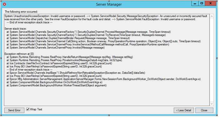

# E10 migration: Application Server Signon Error **Category:** [Epicor ERP 10](https://www.epiusers.help/c/e10/5) **Created:** 2016-12-09 18:35 UTC **Views:** 5151 **Replies:** 9 **URL:** https://www.epiusers.help/t/e10-migration-application-server-signon-error/36572 --- ## Post #1 by @wi11king777 Using the Migration guide to migrate from 9.05.702A to 10.1.500.7. I am on the part of configuring the Application Server, but stuck on signing onto first time with manager/manager. I get error : “Application Server version has not been verified. Review the Error Message below to troubleshoot your connection issue. It may indicate you need to manually install a newer version of the Administration Console to connect or that it is not supported. Error Message: Invalid username or password.” I am using manager and signed on as Windows Administrator with the Domain\administrator, Domain\epicor, and NT Authority\SYSTEM with SQL sysadmin server role checked. Any help will be appreciated --- ## Post #2 by @josecgomez You coming from SQL or Progress? I always have better luck running the migration with SQL Auth... but that's just me --- ## Post #3 by @wi11king777 SQL . When you say SQL Auth, do you mean sa / password? --- ## Post #4 by @josecgomez Correct, on both DB's / Servers... I have horrible luck with Windows Auth... Kerberos is a female dog sometimes! --- ## Post #5 by @wi11king777 What would be the Endpoint binding in the Application Server Setup? I do have sa in the Database Connection, is there somewhere else to put sa in the Application Server Setup? --- ## Post #6 by @josecgomez Endpoint binding is different than DB you can set that WindowsUsernameChannel Then set the DB setup to use sa / pwd at least through the conversion... and see if that helps; --- ## Post #7 by @wi11king777 Application Server Settings: ...EndPoint Binding: UsernameWindowsChannel ...ApplicationPool: Custom Account : unchecked and not used Database Connection: ...ServerName: local ...Authentication: SQL Auth ...User: sa ...Password: ...Test connection (WORKS) Admin console Settings: ...Epicor User Name: manager ...Password: manager I deploy and try to Connect to Application Server: ERROR: Invalid username and password. --- ## Post #8 by @wi11king777 Found a fix. Admin console Settings: ...Epicor User Name: manager ...Password: manager **(One is required to change the password)** I changed the password, but didn't change to the new password in Application Server Setup and redeploy. Also, not found in documentation. Case Closed --- ## Post #9 by @mhossain [quote="wi11king777, post:8, topic:36572"] One is required to change the password [/quote] I am facing the same issue. What do you mean by " **One is required to change the password**". I have setup the username/password manager/manager on Admin Console Settings. --- ## Post #10 by @MikeGross [quote="mhossain, post:9, topic:36572"] I have setup the username/password manager/manager on Admin Console Settings. [/quote] You say that you have the same issue - so this is an upgrade. You should use the current password for "manager" that is valid in your application - in other words, the password you would use to sign into E9 as the manager user. --- **Canonical:** https://www.epiusers.help/t/e10-migration-application-server-signon-error/36572 **Original content:** https://www.epiusers.help/t/e10-migration-application-server-signon-error/36572
