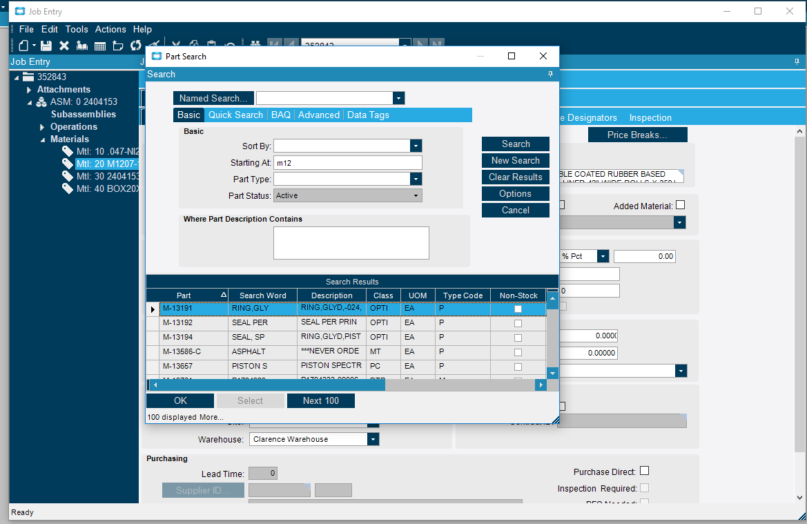

The part search in E10 is acting different than it did in E9.
If the part starts with a letter, it pulls up parts with that letter and then special characters first before searching for the rest of the part number.
See screenshot
If we scroll down through the list after the “M-” parts our search parts start to appear.
How can we change this unwanted search behavior?

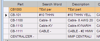

Remove the grid sort.
Here’s an example w/o a grid sort:
I searched for “CB1” and CB1000 appears before “CB-…”
After sorting the column by Part, CB1 appears below
Thank you for the suggestion.
We had to remove the grid sort then save layout and it finally works as it should.
