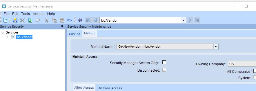

I have set the service security and was wondering if there is a way to change the Error message from out of the box Epicor to more details for the user, instead of just “Access Denied”. Thank you in advance.

Not through service/process security.
You could create a method directive BPM on Vendor.GetNewVendor with a condition based on user name/security group (just like in service/process security) that raised an exception message with the text of your choosing.
