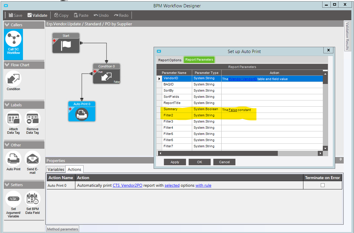

I recently wrote a BAQ Report based on the Vendor and a UD table. I would like to use a Standard Data Directive BPM to call that report and generate an email based on that unique Supplier. For some reason, the BAQ continues to run for all Suppliers. I see that Standard Data Directives allow you to specify Filters and Options. How do I get these to apply to the BAQ at time of BPM trigger? I also see that the Filter1 field is missing from the list. Could that be why my filter value isn’t getting applied?
For this specific need, if you add an option field on the BAQ Report form for the VendorID, then the BPM can set that field when running it.
Thanks. That’s what I thought I was doing, but for some reason, it doesn’t work.
You may need to send screenshots.
