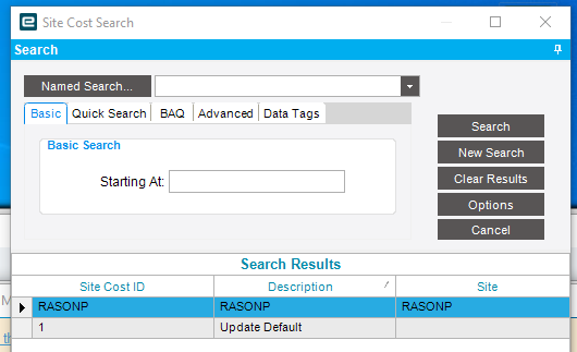

Now we changed direction and have added it as a site and it has been given its own cost ID again. The original owning company never set up a cost ID for themselves and used the Epicor default placeholder that is in the system identified as 1 . With the addition of the site we did establish its own Cost ID to make sure that the cost rollups would not be mixed.
We now are unable to do a cost rollup and have the materials come in
