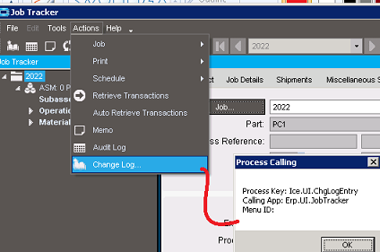

Yes - in Job Tracker. I can choose Actions Change Log but when he tries it says he doesn’t have access to this menu item.

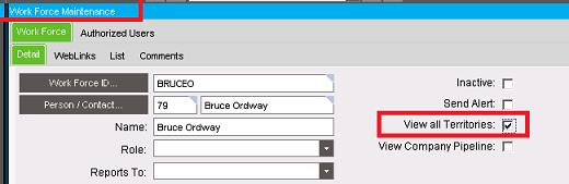

I’ve seen Territories do weird security “stuff”…
where to get around it I’ve had to add a workforce with “View All Territories” set to true for the user
Or… possible some form/process security - if you turn on DevMode what displays when you open Change Log from Job Tracker, e.g.
