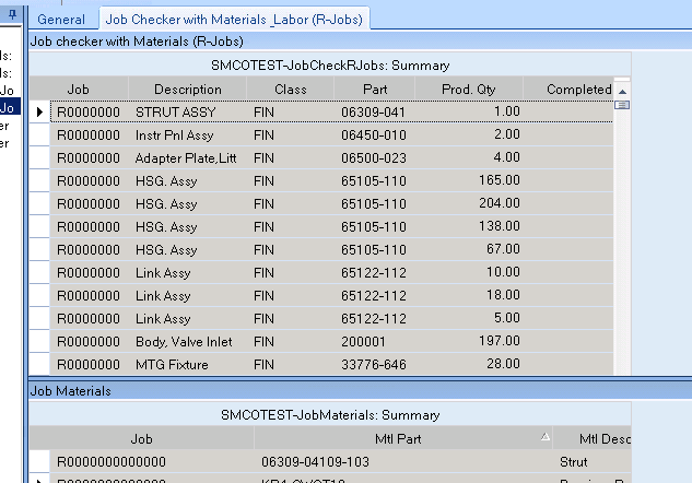

I have a dashboard which somehow changed the size of the queries. I cannot resize this window. I tried resetting all layouts, etc., pinning and unpinning. In the image, there are several more fields to the right on “Completed.”
This is typically due to Dashboard definition getting corrupt. Sometimes clearing the cache will work.
What I have done in these cases is export the dashboard and reimport under a different name.
