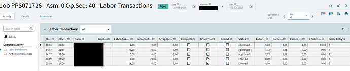

We are encountering an issue with a LaborDtl row where the Earned Hours are showing as 0. In the Field help you can see that: Earned hours for production labor is calculated as (JobOper.EstProdHours / JobOper.RunQty) * LaborDtl.LaborQty. From my BAQ I can see that JobOper.EstProdHours = 9,28 JobOper.RunQty = 116 and LaborDtl.LaborQty = 76. I would think that the earned hours would be 6,08 and not 0.

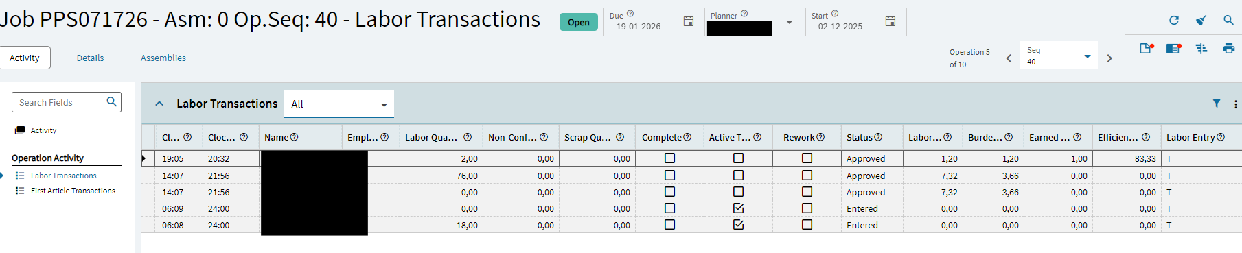

Thanks for your reply. Since this a sample production order, that could easily have been the problem. However the crew size is 2 here. To me it is also very weird that the setup labor transaction is showing earned hours normally, but the production labor transactinos are not.
