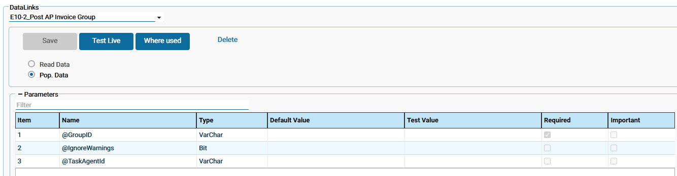

As for a solution, I’m not sure of the best way to do it, but you could create a custom API datalink that initiated the posting process, OR you could create a BPM or DD that monitored a value on the AP Group (updated by your ECM workflow) which would trigger the posting process. Or if you have some other API Automation tool…
