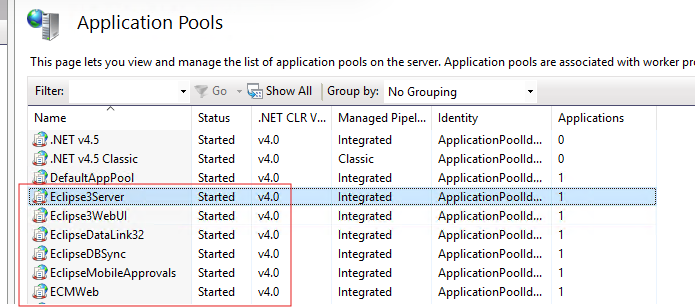

We tried restarting the app pools for ECMReporting and ECMWeb. Any others you would try?
I also spoke with our IT department about whitelisting some IPs since we have been going through some internet issues and changes that coincidentally started this weekend (same as the 2026.1 update haha)
I believe the important app pool is Eclipse3Server, but I would restart all of them.
