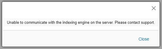

I’ve had this error before, but can’t remember the fix annoyingly! I’ve checked back through my EpicCare cases, and the tech agent hasn’t updated the notes either.
Anybody seen this?

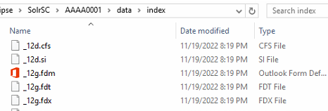

Worked with support for an hour or so yesterday, but didn’t get to the bottom of it. I think it’s going to be permissions related. If I uninstall the Eclipse Solr service, and empty the directory that I’m asking it to create the index in (E:\Astria Solutions\SolrSC), then I run the Server Config, it reinstalls the Eclipse Solr service, and upon startup it places some files in that folder - BUT, just not all of the same files that appear on my current server. It had them stumped as well, will post the resolution after I’ve done a follow up on Monday.

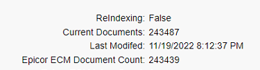

I think the naming is random. I used robocopy to overwrite my dev system’s files and restored the dbs from live. (I know drinking and programming is dangerous) I started a rebuild at the same time on live and dev and came out not only with different names, but also the number of files. BUT the same number of indexed documents.
I verified that I had the last PO sent on Friday back to 2020 when I started with APR.

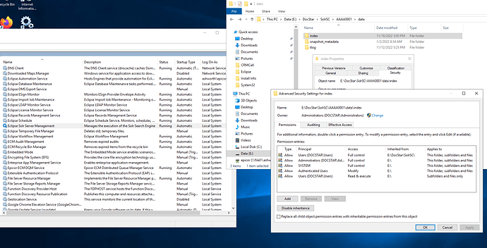

Just to throw some more info into this if you think it’s permissions - here’s the permission ‘tree’ on my server - services and Docstar directory down to Index. Note that I’m on a separate drive and not in the protected Windows folders (Program files/Program data/etc.)
