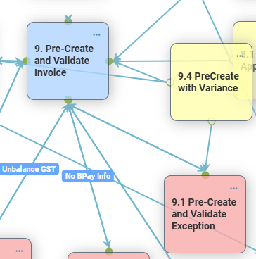

My workflow loop through Pre-Create and Validate Invoice
This is to allow user to fix up Tax variances.
I have noticed that after the Datalink Pre-Create Invoice that there is a field that when I run it 2nd time, the AllowTaxChange will be check to true.
Here is the recorded output from the Datalink Pre-Create Invoice. The GL Analysis has duplicated. Has anyone got the same issue?
