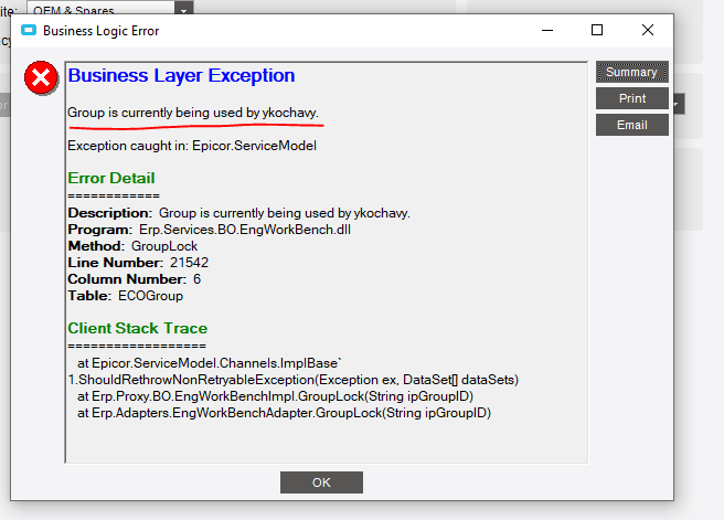

I have a ECO group that was in use in Production and when I restored to my TEST environment it shows the group in use. Anyone know how I can release this?
Login in as that user?
Can you log in as ykochavy and “Sweep” the ECO group? That will most likely release it for you to access it.
I did log in as that user and changed the ECO group not to be single user…it worked…not sure correct.
You could have checked in the part(s) in the ECO, but what you did also works.
