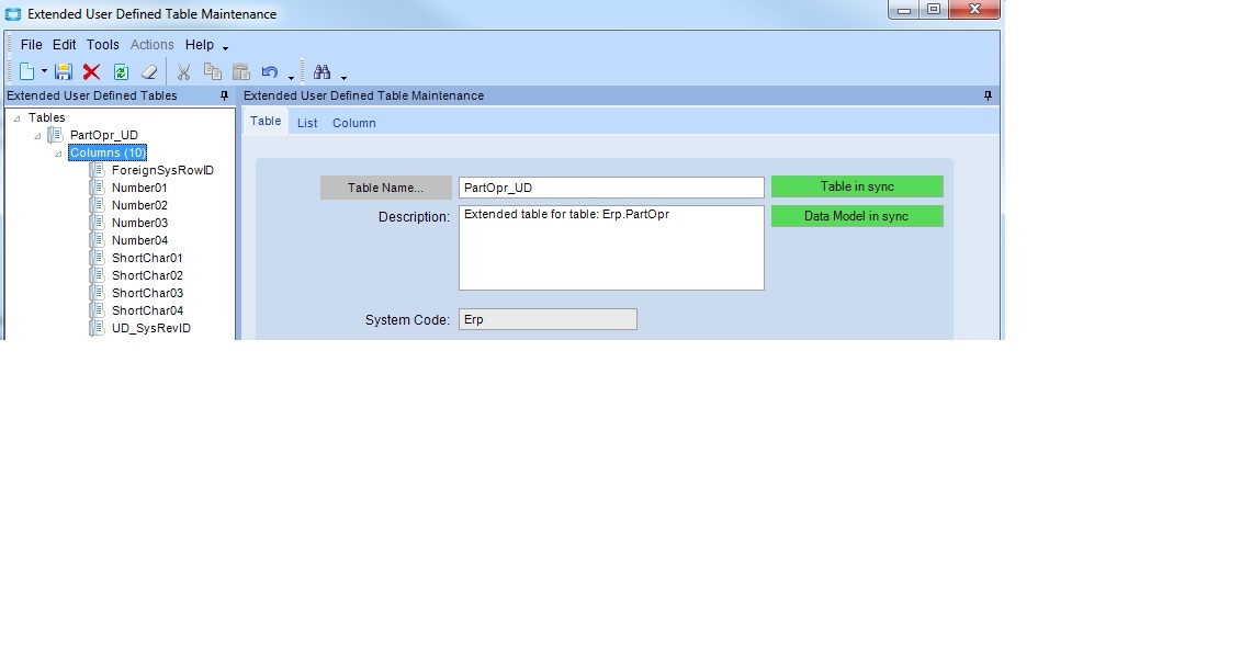

I have created 5 UD fields in ECOOpr table:
Number01, Number02, Number03 -- decimals
ShorChar01 and ShortChar02 -- strings
ECOOpr_UD table is in sync and data model is in sync as well.
Now when the engineers are trying to input data in those 5 UD fields from Engineering Workbench, it saves it in the DB after they click the save button, but, when they approve and check in the revision the window is cleared like it's supposed to do.
If they open it again, that same revision, the data is not retrieved in those 5 fields. They are all empty.

## Post #2 by @josecgomez
Hi Johnny
You'll have to create the same fields in the PartOpr table, then use Extended UD Table Field Map to link the two fields.

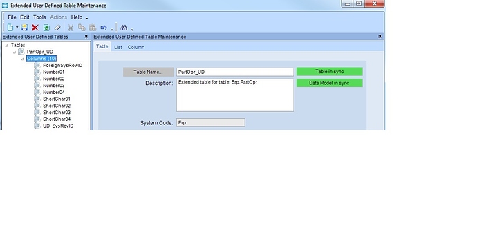

## Post #3 by @irus26
I only created those exact same fields in JobOpr table, but not in PartOpr.
I'll do that now. Thanks!

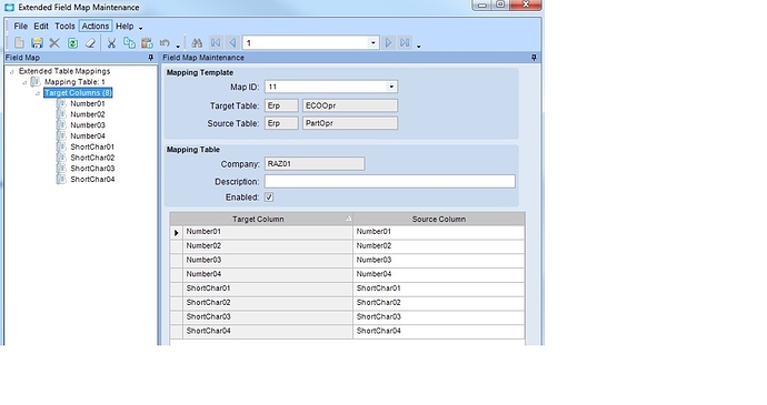

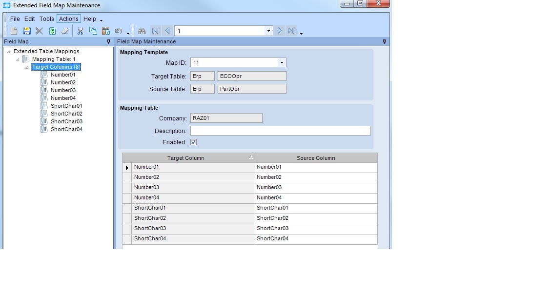

I mapped everything as you told me, but the data is still not retrieved when I check out a part....

You need (3) mappings so the fields are passed both ways.
Source Target
PartOpr --> JobOper
ECOOpr --> PartOpr
PartOpr --> ECOOpr

## Post #9 by @irus26
Brian,
I mapped all 3.
MAP ID 10
MAP ID 11
MAP ID 33
Does not work.

Map ID 17
Target PartOpr
Source ECOOpr

## Post #12 by @irus26
Now it works. With those 4 mappings and a reboot.
