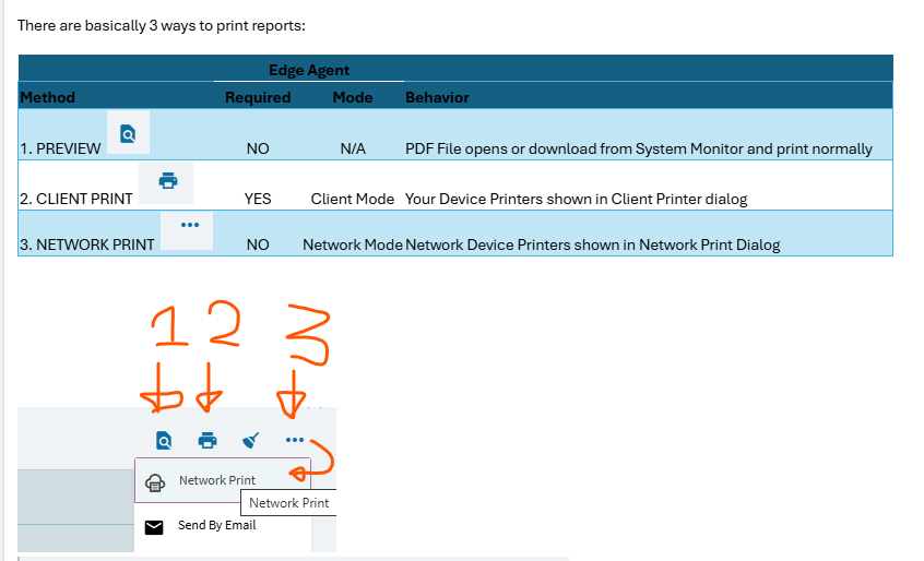

Perhaps he means stations dont need Local EA installed to print from browser to Network Printers made available with Network EA service running on at least one on-prem box.
janky doc for my users: :rofl:

@jbooker’s post above is correct there are three paths to Print from Kinetic Browser.
1- Print Preview then print to physical printer (No EA required)
2- Printer icon - Requires local EA installed
3- Network Print - Requires a networked install version of EA on a print server in your network (also work with Support to get this mode enabled on your environment if you’re SaaS)
Note: One minus to #3 above is that you can’t set a “Default Printer” so the user must select the printer from the list presented each print.
