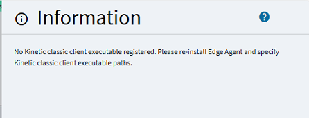

Come to find out, you can just skip pointing the Edge Agent to the Client config paths and manually type the site URL. At least for the Network Edge Agent.
Installed on our new terminal server in multi user mode and seems to work well. Local printers show up for multiple users, access to network share attachments. Opening the few classic menu items we have remaining brings up the following error:
