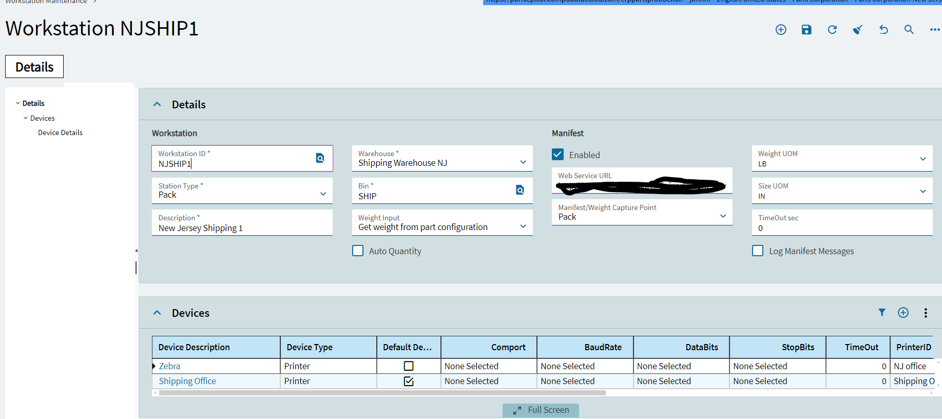

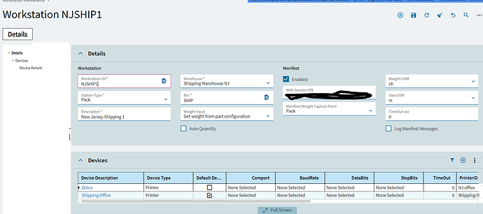

Copied one of ours below. Under Devices, the PrinterID should match the printer name as installed on the app server.
Thank you for the quick reply - our set up does not include individual workstations set up - not sure if that is a requirement with cloud based SaaS, which we are. But I did check that the printer maint set up for that printer matches our network server, so that box is checked.
We’re on-prem so it will definitely be different. Might want to check in on that other thread I linked - I think someone mentioned cloud with an onprem BarTender scenario
