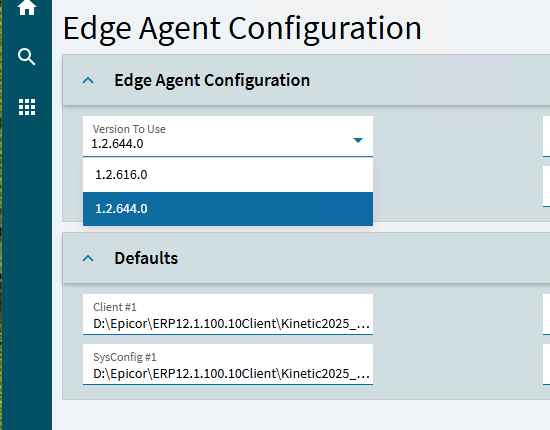

Point to note also in the Edge agent maintenance screen you can select the version to download and configure.
For example
