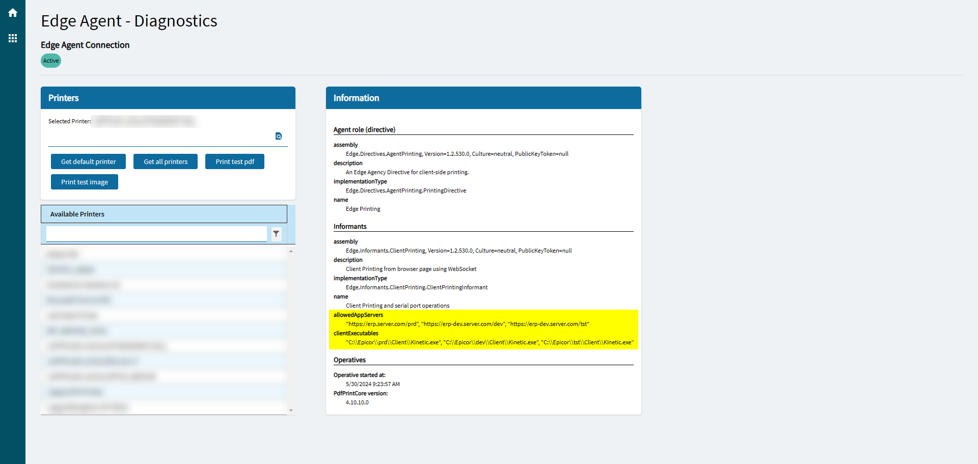

Beyond re-running the installer, or locating the appsettings.json file, is there a GUI way to see the configured App Server URLs for EdgeAgent?
Ideally they would just display on the diagnostics screen/page when you open from the tray. Are they visible somewhere else?

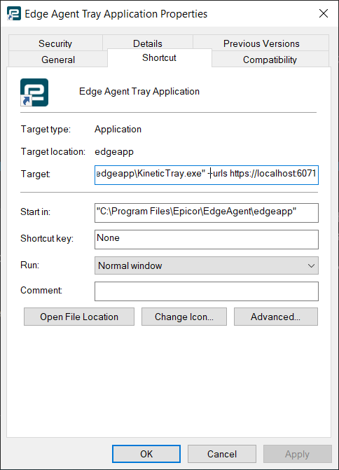

Turns out the server URLs look like they are in the shortcut properties

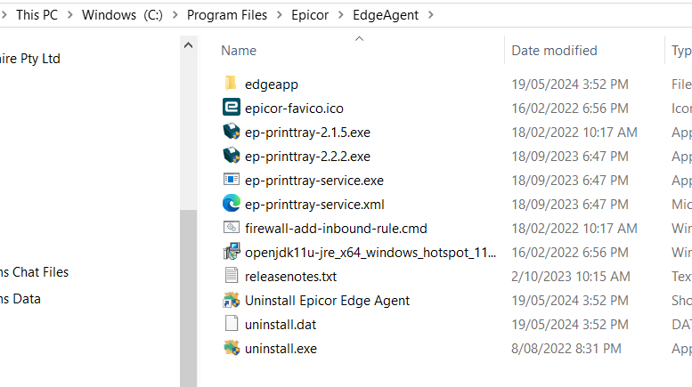

I did not see a config file in the folder although there is some interesting stuff in there
not sure what the printtray demo folder is about.
So that URL on the shortcut is just to the Edge Agent, not the environments.
