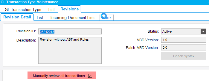

Have you considered just sending those transactions to the Review Journal? You can do that in GL Transaction Types. This will let you post it and review/confirm/cancel it in the RJ so could act like an edit list.
If that doesn’t work, you will have to create the report and or show the information via customization on each screen but that might get involved. The general ledger data will be in either the TranGLC table or the GLJrnDtl table. These tables will have to be tied to the corresponding transactional tables in each instance.
