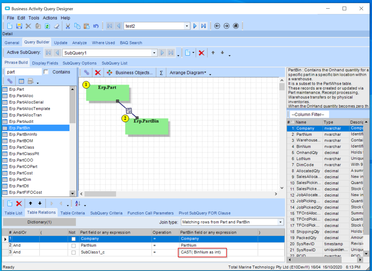

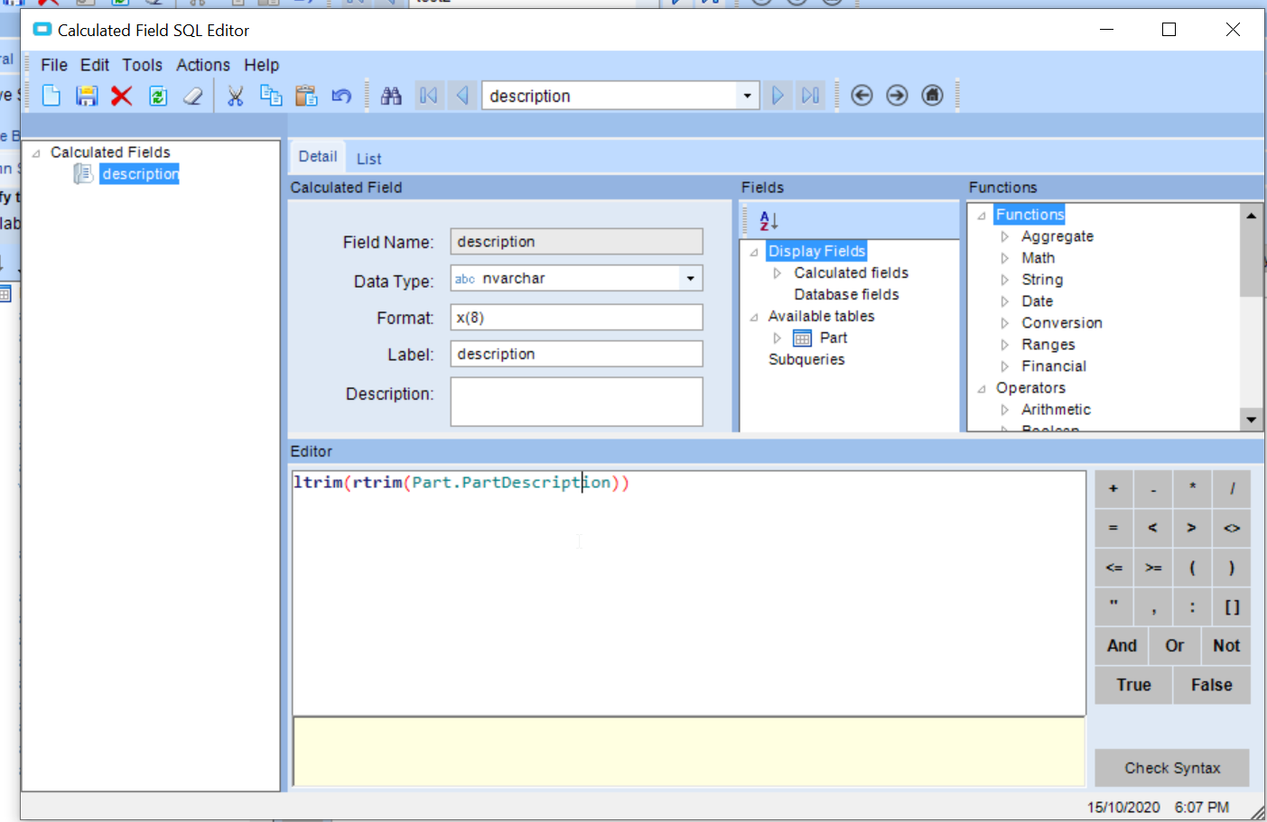

Ah, you can use SQL functions in the BAQ.
In calculated fields you can use SQL. If is not in the available function in the UI you can just type it in. Similar for the Where Criteria.

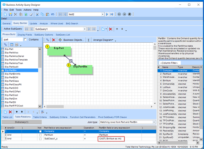

In the joins you can also type in what you want. For example if you bin nums are all integers you can cast them in the join.
Brett
